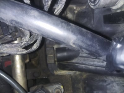

I have a 04 4.7l 1500 i have been fixing vacuum leaks for days now trying to get ride of a p2097 at first it would reset after abput 50 miles. The other day it cleared for almost 200 miles. I even got the truck to pass a obd inspection. It came back on and stayed off for a day or so. But i ended up a air fuel rich mixture code and it seemed to still have a small vacuum leak somewhere. I have replaced the intake temp sensor because it was not working at all. The truck was idleing pretty good every once in awhile it would raise to about 200 to 300 rpms. Today i found the pcv hose on the back of the intake cracked but the auto parts was closed so i was unable to get the correct hose so i used regular vacuun hose on it. I have been unable to find the erg valve on this truck indont believe it had one unless it is located some where since it is not behind the driver side head. It seems to me that the vacuum leak is coming from this peace here but iam unable to close it off. Does any one know what this piece on the intake is and should it be there. My fuel mileage is really bad like 300 miles to a tank or so. Please any advise on where to look and would be a great help i am flying blind on this one. The truck is running really bad as of right now it has never run this bad. Also there are to vacuum ports on the intakr which one does the hose off th
Booster attach to i may have mixed them uo because one had a plug and the other has vacuum hose from booster.

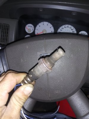

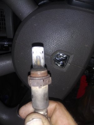

Well guys I'm still fighting the p2097 code I think I may may have got it figured out though but my idiot self dealing with this code for as long as I have been messing with this code knowing that is bank 1 Post cat reading rich symptom my it itself went and replaced the Upstream O2 sensor for some reason today. So now I get to go and buy another O2 sensor waste more money that I don't have at the time I replace the downstream sensor bank 1 driver side but I'll keep you guys posted on it I'll get it one of these days but I'm about ready just to give up if this doesn't fix it fix it I don't know what I'm going to do I don't know why I did that either I worked in the shop before work in a Ford dealership what Ford's are little different the dodges and I'm flying at this one blind with no diagnostic tools because all my stuff was stolen from me but I am going to give me a good little scanner here pretty soon I'm just going off of what I know and what what I'm reading and what I've been told about dodges it would be a lot easier to fix it what does cancel but I'm on such a tight budget with just coming back to work I can't afford one right now if people I know don't work at Dodge they work at Ford and they don't have any scanners they use all IDs

Thank you fast i got her fix and she is a running good. The finally fix to my issue was the down stream 02 sensor. I would say tho that the issues that i did contributed to o2 sensor going bad. With all the vacuum leaks and iat sensor laying on the intake. The cai not being installed correctly and the map sensor wiring and the throttle body being completely dirty, i would have to say it was all a factory in p2097. The finally fix was putting an 02 sensor tho i just fixed the issuse before the 02 due to i knew the other issue were there becuse i could see and hear all them so i wanted them fix to see what would happen. But they were part of the issue and could have caused a rich code p2097. Thank u for all the help. If u ever have any problems with ur vehicles and need some help just feel free to ask i will do everthing i can to helo you solve a problem.
