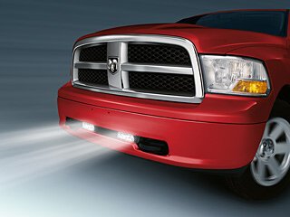

I just installed these foglights in my lower bumper grille:
Problem is the installer tossed the plastic insert that was in there before I remembered to ask for it so I could cut off the two ends and cover up the gaping holes that are now there where tow hooks would normally go (and no I don't want "just get tow hooks man!" as a solution lol)
Any cheap suggestions on how I can cover these? I'm even willing to do some kind of DYI with a couple of pieces of plastic from something else. There's still holes inside to bolt something in there.

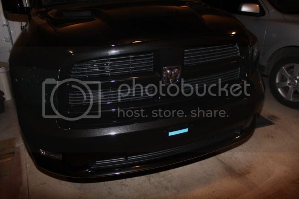

ok found a couple ideas for us. For about $10 you can buy a small sheet of metal mesh, or another idea is a strip of mesh gutter guard, paint it whatever color you want and then cut it to size with some tin snips. Put inside the lower bumper grille where your openings are and just zip it in place with some plastic cable cable ties. I ran a cross some forum posts with pics after googling "DIY dodge ram grille" and they looked good, you won't even be able to tell it was a craft project. those companies selling "kits" that do this for $200 don't look any different once you're all done.
Another guy made a pretty cool set for his entire front end using black wire looms:
