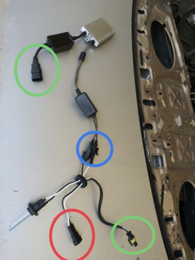

I would do this in two separate phases in order to isolate potential issues.
First, get the conversion harness installed, and run the new projector headlights with the original halogen bulbs to make sure everything works, and there are no errors. Using 1500ram12’s pic in the previous post of the conversion harness, plug the big 14 way connector into the projector headlight housings. Plug the truck’s black connector into the 3-way connector on the conversion harness that has the resistors on the wires. Plug the truck’s green connector into the other 3-way connector on the conversion harness. Use the original halogen bulbs. Slide the headlights in the holes temporarily so they don’t fall off the bumper, and run through all the headlight switch settings with the truck running. Check the highs and lows to make sure they come on. Check the parking lights and make sure you’re not getting any bulb out errors. Run each turn signal for a good minute or so, and run the hazards. If all is good, install the HID kit. NOTE: if your truck originally had dual headlights (one bulb served the purpose of high and low beams), then the low beam bulbs will turn off when the high beam bulbs are turned on. This is normal.
For the HID kit, this is how to connect everything if you are mounting the ballasts outside of the headlights:
Green circles- connect these together
Blue circle- correct
Red circle- plug this into the connector inside the headlight housing that you unplugged from the low beam halogen bulb.

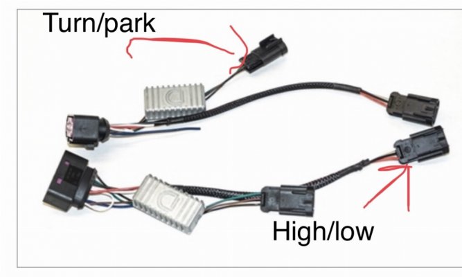

Thanks a lot guys. When I hooked the conversion harness to the factory projectors, just headlights or parking lights will only work. Not both

I forget but you said you could either get park/turn to work or low/highs to work but not both at the same time, correct? Are your headlights oem or aftermarket?

Factory projectors with ram insignia on them. I have narrowed it down to the projector harness from Jeremy.
With the amount of morimoto parts he sells, he should have a secretary.
Now I have to wait to be able to use just my factory projectors.
I had an issue with my set and tried everything.
It turned out to be one of the relays on the power harness.
