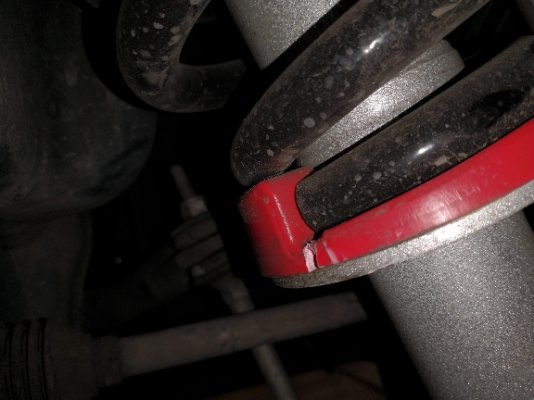

Also i had rancho, both spring isolators broke. Rancho does not make warranty claims nor would they send me new parts so i had to get refunded by amazon. c6d42be08cad5d59042c310358255a1f.jpgd31e8a5844c993b158852a59c7ba31bb.jpg

Yea i heard you're exact review on amazon and others said rancho bad reviews everypeople said it wont last... even one said the lift was gone 3 days later... but why dont you recommend rough country?
