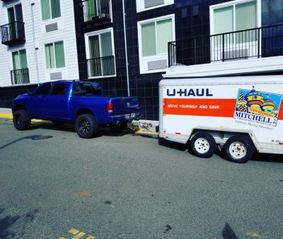

You'll notice a power increase going from 85 to 89. Is the back end of your truck sagging? Are you lifted?
My truck had no problem pulling my uhaul trailer loaded with beds and furniture moving from WA back to AZ. Plenty of 6% grades going through the rocky mountains.IMG_20171005_102944_292.jpg
