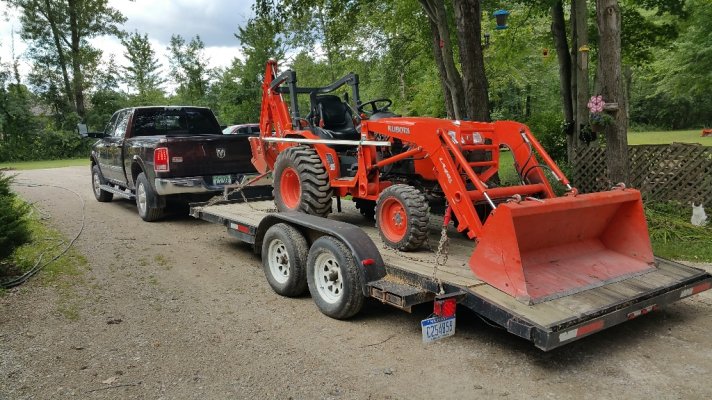

I run a 10" drop hitch on my 3500 and tow my car hauler at an 8" drop. I think a 3" lift is going to put you close to where a 3500 sits. I run a Weightsafe drop hitch. Here is what the 8" drop looks like.

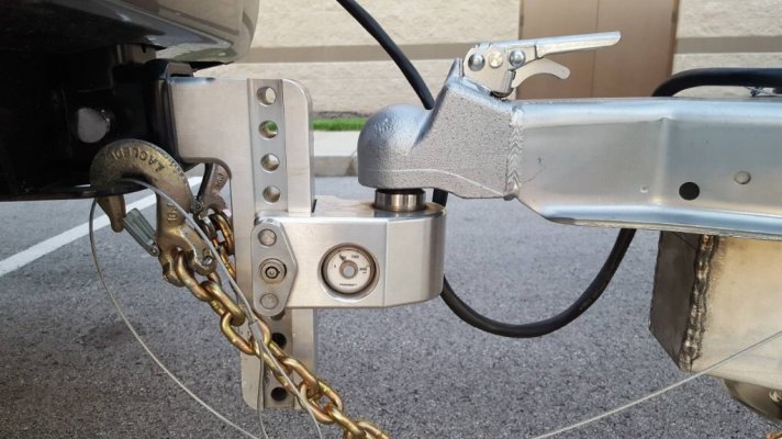

Get an adjustable 10" drop hitch. Most have an 11" rise as well.
I got mine from etrailer. Great outfit to do business with and they have a large selection to choose from.

Something easy to set at custom height is ideal for sure. I run the Shocker hitch made in Arthur, ND they have a website but I find the hitch to be amazing.

This is how my stock 2500 sits with 10" drop weighsafe and my 28' car hauler hooked up empty and fairly level. I would think if you plan on lifting your truck, you're going to want that 10" drop to leave a little versatility.d463709924231aba503ef4b7349e37f2.jpg1c0f1a295c48b1b100df7f6624657002.jpg
