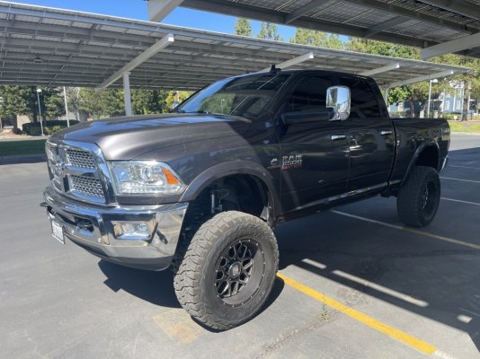

TRUCK HAS 7 Inch lift and cant find any shocks with reservoir for front.
Any Suggestions?! Called Fabtech and they dont offer these shocks anymore.
