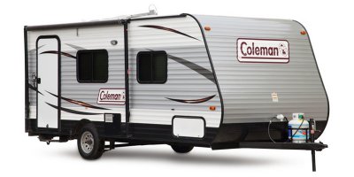

Looking at campers like these

Not looking at nothing big...

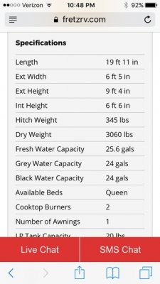

Found the specs on the trailer -
Hitch weight of like 350 pounds-
Dry total weight of like 3200 pounds.
There where 3 different floor plans - I pasted the heaviest-
If you want to know what 3k pounds is gonna feel like behind it truck- get a u haul car trailer toss a good size sedan on it and see how it feels. I am sure we have members on the forums that have lifted 1/2 tons that tow heavier loads on a daily basis and hopefully they chime in

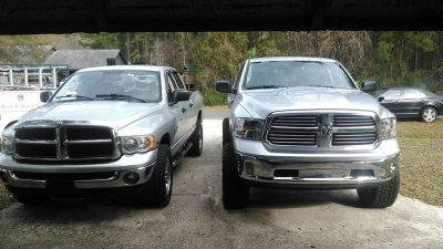

Here is my 2005 beside my 2016 for reference
