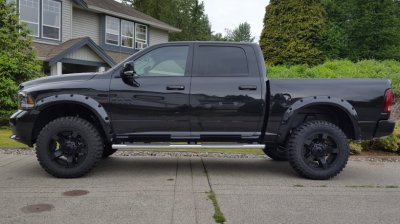

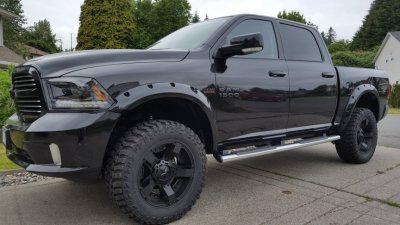

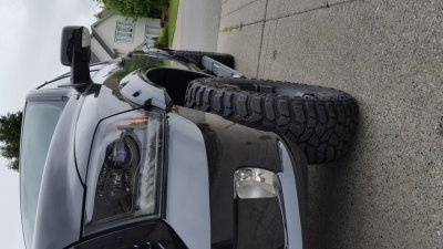

Another note, I just got done halfway installing my bushwacker flares. Not sure why but im thinking they stick out to far? My tire rims setup is 35/12.5 tires, 20inch rim, 9 inch wide, -12 offset. My tires look tiny now. Didnt think it would be a issue, because it looks like the tires stick out about 2 inches
Do most guys on here run spacers with the bushwackers? Not sure if I like them. On the fence? love the flares, and want to protect my paint, i was replacing my hemi badge with black one and noticed a couple rock chips already.
