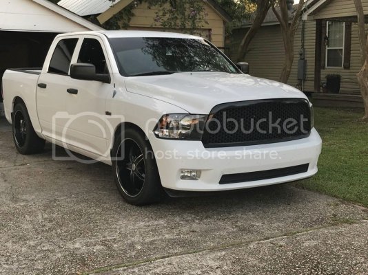

Well I appreciate the help. I'll keep digging further into it, but if there's an risk at all I likely won't do anything hurt anything on a 50k dollar truck so I'm pretty certain I'll be just dropping 2 in the rear only
I think that's what I want to, but then need airbags because I tow quite a bit
