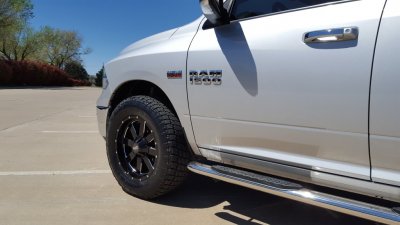

I just got 285/75R18 Falken AT3W's on my 2019 2500 and i'm super happy with them. They're as quiet as stock, they look great, they seem to perform well in all conditions including snow (did some plowing) and they handle extra weight very well. They were also very reasonable on amazon $232 a tire + $8 per tire install at a local Mavis.
-j0AoeldOMEY0hTirebHr_mIqV8-ZbNxJ-RzNadiAvG-Yz0VbI1XR8Q6GLQICoYQ4lCqYVrau-LK1UrxqjhJX4HprSFIF4mMcS9coe2emUcbxuZtaCxdS2eWab9IFp9BHEqKL0EPaDMKFNRg2-tIXeuzqfmnt326Vx03Cto8JU0X_8T8_Cqfzfvvg_poblxnnmx2jLPnb71iO3CSHINBtrvCKL7UGSnPz9J32PMMVDNToMsVPyht-nGS6Iue8UNlQTFLPbPssjKVXuwWM2VbAYXWEVHe4PeIuFLSUMsLHJ1XtyDvOD7syI4ifysNBNryf-6dsYFNGp2oTmNrMphOg0pWGA5acEblcfFLBJ03HAE7AZv-5Lh_CNXEjedi-8v0c_JpmCnIotnOEkDe3x70W5Wofs0IO84JK7pJsS6caI5_FR5Xx-ol80yGzcHPHvopUx1-uCpntFoo-TMBIu8jA-Jvf61tz_rzdWsAnMi4NsZv4rcSw-9A5WkXwn3bskgFT9OxK57l59dxZ75WlIn3flEQG7krFVfd-MYhnFFcHrJd7F5CIRo39e69fFkuEk5iTh9aNf6w1vuKh8kSUHam06gqMZW8JXgs_un-5nkSlSMTCwj-BgNIDYimQhJq7G0Mqglakr3B1-krBjN7NT3lOkA_MqCPyr79Q8BLT0wflQ_URSOBARKRW_XDcugKjZE=w1210-h907-no
PqHMdGH-ws0W6WqFMbXJeiUZZ11ySWOgmBOxkVwznmcM2u8DfgNBzWLJcu_yUW_OqoW6IViw5OlowP1WJuzo7l5OIQOj9UL5fStp6kzckXaeBh2B7DYOnBmYiDEa12IS9DDsn-0zbmkIcpBUDELV5r9WMrmid2YI7ggXmuPiTaPMjAuk1I0_CJXOPfCR874-dIQE-Yh30Dfza-4RVUVzMrau_eqv-e4kocQo7-O4ddomWvjJOdORJxFu204f1Nh6W9jdifZ-LhYSPNVn8d4d4Ri-0QhvIC3K6V_LaU9Oc2_MVcS4bZaQdzQNeN0H3FqBvfwARojCOqnghyR5xaapsNWvMeJhwo7qyFhr20Cq7QFXJYH-YjO6jYOZvEHoPD7rK_CL7cqP2843IhNmKQ_L1Q3WafHqMSRAZY6tLjpqjux1tdrqHCQjdHKVxw7RvmH52WG7tPJ-trbmwP0I3YoFMBwPtQ8S5Y0j2B-_PJalDRLjmEiZL0aWcTZrLEyf4QhYD3pxVe8sBR4orpfl1X1RZAXlEsLK8lJQPFAa2_DumPFxjZnIx6d88JU2ZF42sRqsKFCSrQcgygPcEcP7o4My6zL6La7Vr81Lz0vCUcCjDEfPYowEh3DmYqnwoN6cEyvYMOQGvWFJKPEvP-Q6-skRHa8il8h8O16zAivwCKOraoauqCy-r2m_O9iZdfyKd0o=w1210-h907-no
I've had BFG Ko2's, they were pretty good all around also, but i had balancing issues with them, and apparently that's becoming the new norm with BFG. I also had Terra Grappler G2's and Michelin defenders on my 2015 Ecodiesel.
The G2's I had were 285/75R17 and to me, were just all around Meh, not great, not terrible. Sold them and got the Ko2's for my winter tires.
The Michelin defenders I had in a bit of an oddball size 285/60R20 and were strictly a warm weather / towing tire. They were unmatched for Wet & Dry traction, they wore like Iron, and didn't flex with the trailer weight (9500lb toy hauler) BUT, and i have no idea why considering they have more sipes than most snow tires, they were god awful in the snow. I don't know if it's because the tread compound is so hard to get that 70,000 mile warranty rating or what, but I had planned on running them for 1 winter until I could get some extra cash to get a winter tire next season. However I took them out in 1 snow storm with my wife to go somewhere and even my wife commented they were scary in the snow and i should get winter tires asap. A good friend of mine also shares this same experience, he only runs Defenders as his summer tires, because in the winter he drives and tows up through Syracuse NY a lot on his way to his snowmobiling house in Tug Hill and it's often in heavy snow. For that he used BFG KO1 & 2 for years, and just a few weeks ago converted over to the Falken AT3W's.
