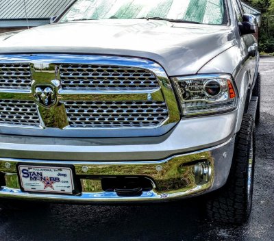

Here's mine. 35x12.5x20 on 20x10 -18 offset. I do have a 4" lift. Check out customoffset.com for more ideas.1551-1.jpg 1577-1.jpg 1555.jpeg 1551-1.jpg

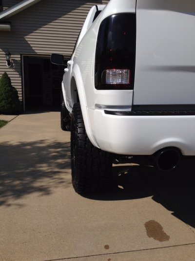

20" X 9" w/0 offset and factory flares w/35" X 12.50's 63bc205eb057dc82d29a8186153cceba.jpg
