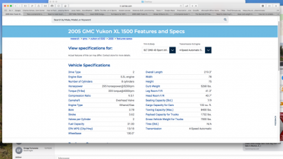

Thanks for posting this! To ensure that I understand, I'm going to use my truck (2005 Yukon XL 1500) as an example.
1. 5268 curb weight. plus me and towables. I'll assume 600lbs, 695lbs for tongue ( Does this mean given this calculation and #4 I could only tow 7437 Max?)
2. 7000
3. 7000
4. 14000 (not in image below, but I found)
5. 7000 + 5268 +600 + 695 = 13563
Pulling this trailer back from Tx to Memphis at approx 6000lbs was a strain. So when I read something that states (like on my truck) that it can tow up to 8400, that's only if towables(payload) is low enough? I'm sorry I have to dumb this down to ensure I got it. I wasn't including tongue weight when thinking about this before .
2. 7000
3. 7000
It is the payload that is the key number.
