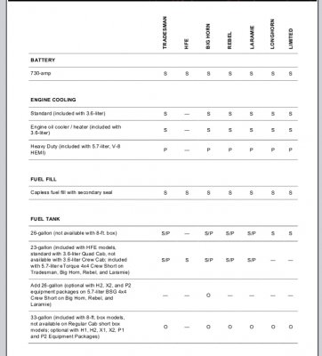

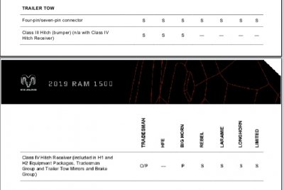

Your Laramie should come standard with the Class IV hitch and 7/4 trailer connector, my 19 Laramie did. It sounds like you got the brake controller that is optional by itself. There is also a Max tow pkg that includes tow mirrors and brake group, 18" wheels and tires, max towing 9.75" 3.92 rear axle and an anti sway bar. The Laramie 1500 is the highest level it is available on and it's optional where available. You would know from the sticker if you had it.
I see no reference to better cooling in any of the 1500 tow packages. This data is from the 2019 Ram 1500 dealer brochure.

With regard to cooling my build sheet says "Heavy Duty Engine Cooling" but there is no mention of that on the window sticker so not really sure what I have. Is there a way to tell if the cooling system is beefed up at all?

so I have a 2019 that came with the tow package - which was the trailer brake and bigger mirrors per the sticker. Looking at the details on the owner site I see "heavy duty cooling" but I can't tell if that is part of the tow package or standard on all Laramie models...

All Hemi trucks come standard with the heavy duty engine and transmission cooling.
If you have a Hemi you have it.
A tradesman and big horn will come standard with a class 3 hitch, which is the bumper.
Rebel, Laramie, Longhorn and limited come standard with class 4 which is the hitch.
The towing package adds the trailer brake controller, mirrors, and hitch on tradesman and bighorn.
On the others it only adds mirror and brake controller.
If you have surround view you will lose it with the tow mirrors.
If you have the higher trims, just add the brake controller.
