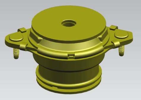

Old thread now but I came back to post an update. I'm getting ready to get a second set of mounts, officially, Cushion Assy - Cab Mounting, part number 68349250AF. My first repair seemed to work but after 3 months I started to hear the clunk again. Not as bad as it got to the first go around but how it started out the first time, so I expect it to get worse. The parts list at $189 each times two. Not sure what causes this but I assume the part is a bad design. Here's what the Cushion Assy looks like.
When the parts dept. looked up the part they came up with multiple numbers. 68349235AB, 68349244AB, 68349249AB and then the part shown below 68349250AF. This part picture is the one to use from the technical service bulletin shown above in Post 183. I don't know if any of the other parts would work instead. They don't look like this. Most were much flatter but if it gets rid of the clunking? Odd that a part designed to make the truck sound quieter, noise dampening, sounds worse than anything you'd hear with an old fashioned solid and stable mount. I assume also that not enough truck owners are aware that this is what they hear or care much to do anything about it. My fear is anything that bumps around this hard in time will hard fail with a result that's unknown. Break loose maybe?
