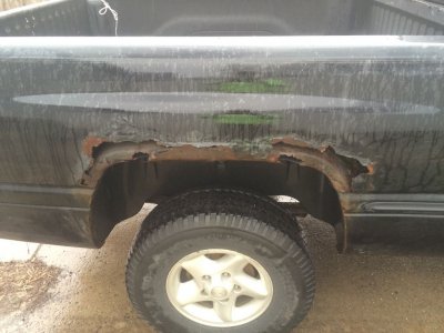

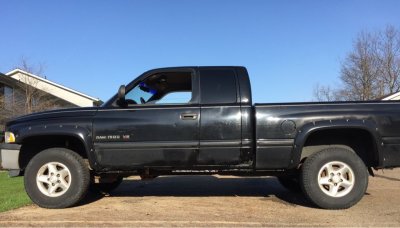

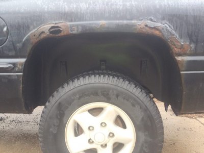

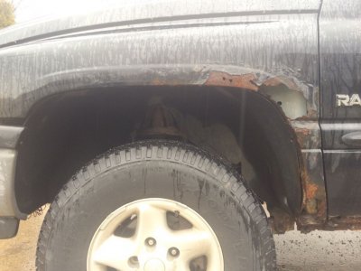

Well, I got the fender flares on after treating the rust spots thoroughly. They came out ok, can't complain considering the mileage on the truck really.
Before:
After:
Is it done the right way? No, probably not, but it at least improves the look of the truck until I break down and decide to buy new fenders and a new bed. Lol.

I didn't even think to use zip ties... I just used self tapping screws on the good metal I could find in the wheel wells lol.
