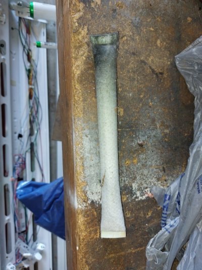

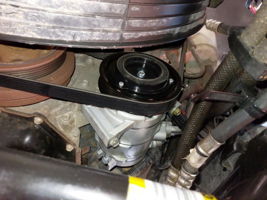

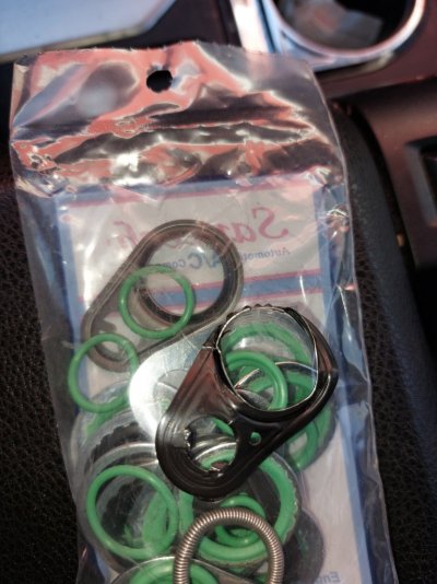

So i decided to go with a new one from oreilly's since it was here in stock. It wasnt all that hard to change out the compressor. I decided to change the filter bag aswell. That was a PITA. Very difficult trying to feed it up into the tube. When i hooked the lines back up to the compressor the green oring fell out and i didnt notice so it actually pulled and held a vaccum, but once pressured up it started leaking, then i found the oring on the ground. Next day i put the oring in. Did the same process but still leaking. Took the suction line back off and somehow the metal gasket moved and i bent it all to hell. So i had to track down a new gasket. You can only get them in a kit... $50 at oreillys or $35 at autozone. Finally got it one and all charged up. Running really good so far. Pic of the desicant bag , compressor and smashed gasket lol
