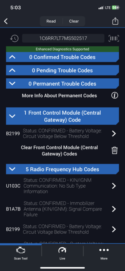

Have the 5.7 with about 75000kms. Just over a month ago I end up with battery issues. Had to jump start a few times. One day ended up with a check engine light and scanned codes.
Had a lot of low voltage codes, understandably. I bought a new battery and installed.
1. Ever since I have lost traction control, I have anti skid but tires will just spin in snow and such. Checked for codes and have no pending or permanent, just status confirmed I can not clear. Don’t know the cause.
2. The voltage gauge when engine is running is always between half and 3/4. Sweat be for all this it read at half but can’t remember. Don’t know if that is normal.

Thanks I guess the voltage is good in my truck. I did try a bms relearn and no change. I still don’t understand how I got anti skid but no traction. My only thought is that those status confirmed are effecting it.
By any chance there any ideas on the antifreeze smell and bearing noise?
