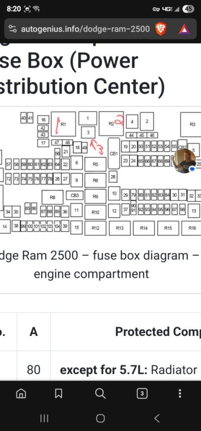

Going to call dealer and see how to warranty my new fan clutch. Purchased April 25.
Was good until Saturday.
It's full engaged / full time.
I have no codes , the #3 fuse is good i checked it earlier. Will check the other 2 when I get back home with my meter.
QUESTION:
Do I have a shot at 1 of the other 2 being bad and causing the clutch to remain engaged?
When i shut the truck down now the fan stops almost immediately, not even 2" of rotation. Pushing it by hand isn't hard but it's not easy.
No play / no wiggle
I didn't want to hijack anyone else's thread , problems are not similar.
Thank you
Also I used genuine Mopar parts 52014729ac

Something seems odd. Fan Clutch is not electrical. It has a silicon viscus fluid that engages the fan. Clutch fan is attached to the water pump.
Those fuses are for the electric radiator fan that runs off the PWM signal from the PCM. No clutch involved on this one. It works when engine temp exceeds a setpoint and when the A/C is on

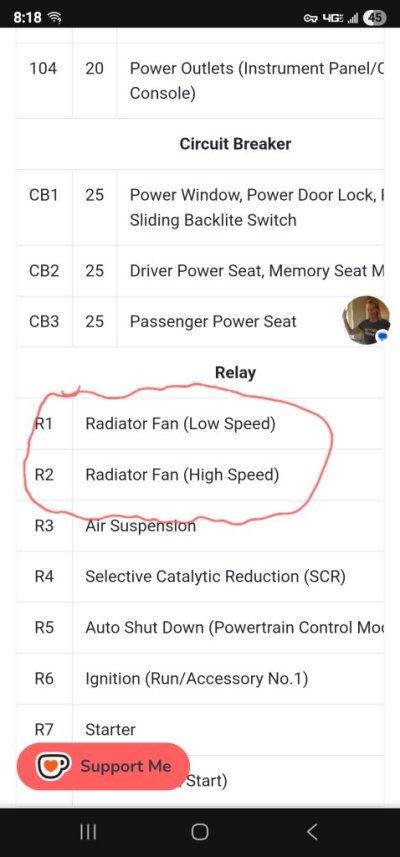

Im going to see what the relays are responding/ responsible for. Maybe the high relay circuit has something to do with fully engaging the clutch, or similar.
Maybe something in climate setting didnt send correct signal? I always shut my air off before shutting down the truck. I have had alot of electrical issues with this truck. 2 hood latch switches, clock spring , headlight issues, cruise switches etc, DEF pump, guage. Im sure I'm leaving something out.
I'll get some butt time tonight at work I'm sure. Going to dig more.

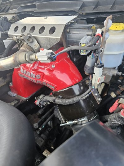

I been trying to find schematics of wiring for my 2015 Ram.
Found this when I did my monster Ram. Directly under my erg temp switch. I zip tied it to the harness for erg valve.
Best i can guess is it is a factory connection for duel alternators? It's capped , just how i found it.
My best guess , haven't found any positive answers, yet. Figured I'd ask here too.
Thanks in advance

The Cummins uses an electric fan clutch,it's differant then what the 1500's use,and is a whole lot more money the last time i checked on one,lol
Missed the whole Cummins thing .
I guess that's why a poster should indicated what vehicle he / she is talking about on the 1st post.

Just a guess, a shorted relay would make it run all the time.
if its running when it don't need to , give the relay a tap with a screw or ? and see if that helps, or change the relays.
