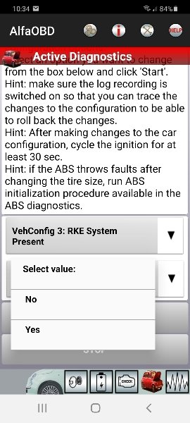

As stated by others your truck may not have come with the remote unlock option but that doesn't mean it cannot be added. There is a good chance you can enable the feature with the Alfa too IF your truck has power door locks and power windows. I'm not sure if or why a tow company would disable features in the RF hub and the Tradesman is not equipped with the alarm from the factory. All that being said you can purchase the Alfa tool and an OBD Link MX OBD adapter and enable the RKE ( Remote Keyless Entry) system in your BCM. If you have power locks and power windows I'm thinking it should work. This is a pic of the RKE code in the Alfa too. 05615be5f5f052b639bdf6826acbc232.jpg
