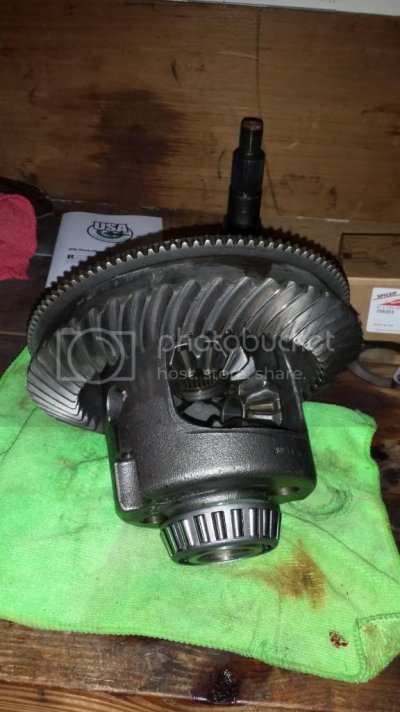

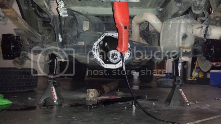

After 3 weeks of owning it the rear end started making horrible noises. Did a little research and found these are common for the pinion bearing going out. No big deal to replace that. (kind of pissed off I hadn't even made the first payment) Got the bearing master kit, and got to work. In the process I found the rear rotors to be ridiculously thin so I slapped on a new set. Finally got the rear end back together and all the specs dead on.. Started the truck up and popped it into gear and low and behold the horrid noise was still there. Pulled it back apart to diagnose a little further. Finally pin pointed it to the ring gear set. That will be going in tomorrow night. Hopefully after a complete rebuild of the rear axle I won't have to dump anymore money into this thing for a long wile. I've got right around $1,000 in it already.

Gear swap - The sales man said he had all the fluids changed even the differentials. I'm going to guess he was full of sha-poopie!

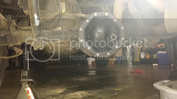

All Clean and purdy!

Finally got the truck back together tonight. I put a short 5 miles on it just running back roads at 20-45mph. Plan on putting 60+ on it tomorrow. Every thing seems to be in good condition. I'm overly paranoid about it now though, any little sound and I start to freak out.
I stopped by the Dodge dealership and picked up some rear diff oil for the truck. They gave me some B&G Gl-4 75w-80. I looked in the owners manual and it says to use 75w-140. What oil do you guys usually run?
