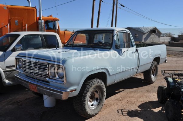

First off I just wanna say hello and thank you for having a forum for the Power Wagons :) I look forward to learning and having a good time while here.
Now for the Truck intro. Well I am a NEWBIE when it comes to power wagons. I have done a BUNCH of searching the last 4 months since I found this PW and still have tons of questions. I don't have the vin written down at the moment but I do have pics if that will help. The things that have me a little confused are the 8 bolt hubs, I don't think those are stock well maybe an upgrade option, the side mirrors look to be installed at purchase so again maybe option from the dealer ? It is an LA360 I believe but don't know about the white 590 sticker on the valve cover, it is an automatic with the Tac-loc on the floor with maybe 5 options lol never seen a transfer shifter with so many positions lol I'm used to seeing 4-Hi-Lo N 2-Hi. So more information about that would be good.
The history behind this truck is that my lucky brother in-law lives up in northern Arizona and comes across RARE and awesome finds of vehicles at least 2-4 times a year lol. He told me about this truck that he got it from the original owner ! ! Don't wanna talk about what he paid for it but it was a STEAL ! ! Anyways fast forward about 3 months and he isn't able to take care of it or work on it as much as he wants. It was running but then the starter died and I helped him replace that over thanks giving (Dang that is a BIG starter) So that helped but I'm not sure what's up with it next. He said it was running a few months ago and he added like 2-3 fuel filters along the way from the gas tank and now it does hold fuel pressure so it will idle and maybe run then sputter and die. . . . ALL that aside if I had more time with it and it was at my house I could diagnose it better but end game here is that I am going to be getting it from him soon :) Buying of course not a freebie :)
Anyways on to the TRUCK **** :) Hope you can give me a heads up of what it possible has from looks.
Sorry for writing a book but it's my first post and wanted to introduce myself and the Big Blue hehehe
OH ! ! And it has 35k MILES ON IT ! ! ! Woo Hoo ! !

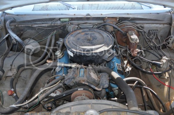

360 ci motor, 3/4 ton dana 60 rear dana 44 front, np203 full time 4 wheel drive transfer case. Mostly guesses out of my old brain based off the pics.

So far just going to run it as is then of course go with better exhaust and maybe headers but the ones on there right now are a black tubular already and don't seem to restrictive ? unless they are garbage lol. But yeah for now run it as is. The tires are 33's on I think a 90's diesel 8 bolt 16"'s so I'm good to go there and those Safari TSR's are pretty nice looking tires with really good reviews :) Just curious if it is the standard Dana 44/60 with those 8 bolt hubs all around and do you think that is stock height or maybe it has a lift on it ? I am SO excited to get it down in the valley to work on it and drive it. It will be a once a week driver and trail/camping/off road fun times truck :)
I think he said the original owner has a 440 supposedly ready to go for sale as well so I might buy that as well just to have lol But I think I read somewhere that the 440 has heating issues and won't bolt up to the 360 bell housing ?

The 3/4 tons came standard with 8 lug hubs. It is a MUCH stronger starting point of a build for you. I am not positive on the 44 and 60 combo, but most 3/4 tons in the 70s had a heavy duty rear end with a lighter front end. You need to check google for an axle id guide. A dana 44 will not survive with 35s and a locker in a heavy truck offroad. It will work fine with an open diff, but if you plan to play hard, go dana 60. You could very well already have one. That truck is stock height. A 440 is a good motor, but no it is not a bolt in swap. Motor mounts, bellhousing, bigger radiator, etc. The 360 can be made reliable and plenty of power to move that truck. Think of it this way, if displacement was that important, why did mopar put a 345 ci motor in 05-12 power wagons? Get it running, drive it, have fun.

Oh I am a HUGE fan of the 360's :) I was only thinking about the 440 since it was available but it's not a need that's for sure. Cam and new carb the stock motor since it isn't even broken in yet lol 35k miles is amazing on that truck :) Just really think it needs a system flush. Not sure if my brother in law did that yet. I like the way it sits right now I will eventually change out the leafs to give it some nicer off road riding and maybe a small lift. The 33's look good and I will probably keep them on there for awhile. The axles from what I remember looked very much the same size. Pretty darn BEEFY ! The front I would swear is bigger then a Dana 44, my friends with jeeps have 44 rears and they look like toothpicks in comparison. But next time I see it or if he brings it down soon I will go all over it looking for numbers and googling everything ! I'm so glad to have a forum that knows about this truck ! ! And I'm grateful my Brother in-law finds these wonderful gems hehe.

360 ci engine, 727 transmission, Dana 60 rear and 3/4t Dana 44 front.
BUT, if the front diff is huge like you say maybe it's a 60 front someone swapped in. I haven't seen anyone say it's a 250. Maybe the truck is a 350.
Lo-loc, Lo, Neutral, Hi, Hi-loc is a NP 203 full time. Heavy as ****. Use 10w30 motor oil. 2.00-1 low gear. Chain drive.
590 on the valve cover is common. It's a production number or something. Useless to us as a helpful number.
Upgrade that big old starter when it dies or you get header's. You'll have to with header's.
A small gear reduction starter out of a 86-95 Dodge. Way better and a straight swap.

He has a 727. Going 440 requires a big block transmission as the 727 bellhousing is not removable.
