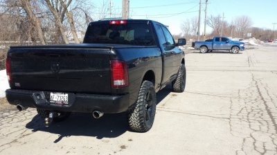

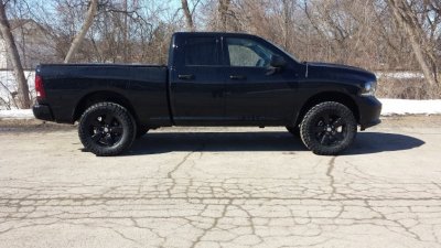

35x12.5x20 amp mt there a knock off of toyo same tread design

here ya go

couple more. there is about a half inch clearance between the tire and upper control arm without a wheel spacer (enough for me), I realize that the 3 inch front spacer isn't the "popular choice"
due to extra stress on the front end but as a brand new vehicle that will only be in my possession for 3 years it should work out fine for me. I also think the motofab kit a quality piece for anyone looking imo. Dodge Leveling Kits

Ahhh, ShawnWhite has the Black Express package which comes with 20x8 wheels, not 20x9. Hence his ability to clear the UCA without a spacer while running a 35x12.50. This is excellent news considering I have the same wheels and I'm hoping to go with a 4" lift and keep the same wheels.
EDIT: Just to clarify, these wheels are 20x8 with +19mm offset and 5.25" backspacing.
