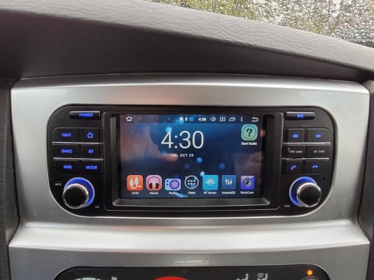

The speakers are also specifically tuned to work with it, all premium car systems are that way. I've never tried it but I imagine just running straight wire to each one wouldn't sound great. Honestly if you're going to go the non-compatible aftermarket route then you should probably replace your speakers as well. This was the reason I went searching for a specific head unit, I wanted something that would work with the onboard set and fit properly in the dash.
Being an Android unit was a plus, my requirements were full compatibility, nav capable, bluetooth, some form of memory card & backup cam capable.

I see. Thanks for the added info and photos. I really wanted a plug and play set up but also wanted a larger display. I bought a custom dash bezel to match (silver) to accomodate a double din set up and it looks really nice. With that in mind I was hoping not to replace all speakers but there may be no way around it. Thanks for your input.

It was made by Insane Audio who unfortunately seem to have gone out of business within the past year or two when I wasn't paying attention.

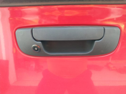

It is a quality piece though and you can pretty much do anything to it that you can do to any other Android device. As I am getting rid of the truck, the head unit is available as is the OEM looking tailgate cam handle and tailgate power lock solenoid. So is the silver bezel lol. PM me if interested.

I have 05 ram and I have spent weeks trying how to bypass amp. What brand stereo will work without the bypass, new speakers, or new amp? Please. Thank you!
The one shown above.
