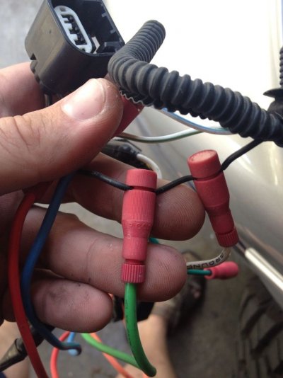

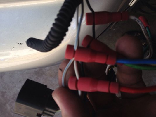

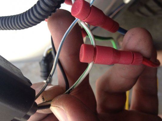

This is what you tapped into right?
the lower 2 wires are ground (lowest) and parking (middle)
now, these aren't exact for your application (as mine were wired for dual color LEDs), but here's how I tapped into mine - I used positaps (not available at the local AutoZone), but any wire tap will do

Yeah that's the plug I tapped them into. The 2 open wires from the Halos that needed to be spliced were black and orange, I matched black to black and then the orange wire to the middle one. The weird thing was that the other headlight had a different color middle wire...

I had them wired right the whole time, but the T-Splice thing you told me to use never broke through the wire coating so it never made any contact haha
