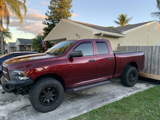

Ok so new body style. And yea leveling struts won’t change anything but your ride height. Essentially they are stock struts with added preload to get you to the desired height. There are no adverse effects from leveling struts. Bilstein 5100 and eibach are a great bang for your buck if you can do the work yourself otherwise the fox 2.0 come preassembled for any easier install. I have a 4th gen 2017 with 35s on a leveling kit with bilstein 5100 front struts and rear shocks to match. There are a few other modifications to my suspension as well but essentially I’m lifted 3” up front and 1” in the rear.
