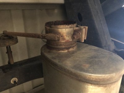

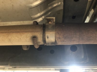

Any real difficulty installing, or is it just get in there and remove clamps and exchange???

I have the single exhaust set up if you have the dual exhaust it’s only a little different. All you have to do it remove the exhaust clamp just forward of the factory muffler. Then the exhaust clam of clamps that are on the of the muffler loosen those. You can move the exhaust. Pipe or pipes/resonators back a little they just hang from hangers on the rear of the truck then pull out the factory muffler and install the mufflex.

Ok here are two photos that I’ve taken. If you are in need of more, please feel free to let me know.
