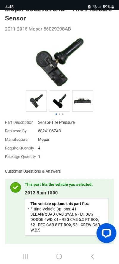

The sensors auto program if they are TRUE Mopar sensors. Everything from 2009 to 2024 for 1500 & 1500 classic models. Even though the sensors for 09 thru 12 are different than 13 up
This part number shows it fits, however, I'm curious to know where you purchased them and are they pure mopar or counterfeit. As you can see these are expensive sensors. At 101. 62 dollars each.

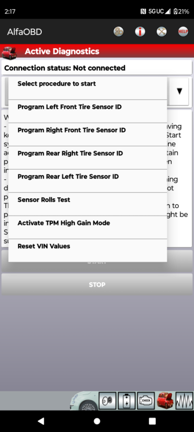

If you don't want to wait for it to learn on its own, I believe you can program the sensor ID#s with Alpha.
This page, I'm pretty sure.
GTyankee
Nov 2, 2020
12,391
17,461
El Cajon Calif. 92021
3.0 ecodiesel
This was submitted by Jimmy07 in January 2019
They’re SUPPOSED to learn automatically.
You can manually program them individually with the alfa, but you need the sensor ID off of each one.
The only way to get that is to have them in hand, or read them through the tire with a TPM-RKE analyzer.
