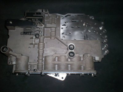

hemidup
May 3, 2014
150
42
2005
Supercharged 6.4 Hemi
Here's a sneak peek.
fasthemiram12
Mar 11, 2013
804
206
Eagle 5.7 vvt
Jerry... I still need to send you mine
