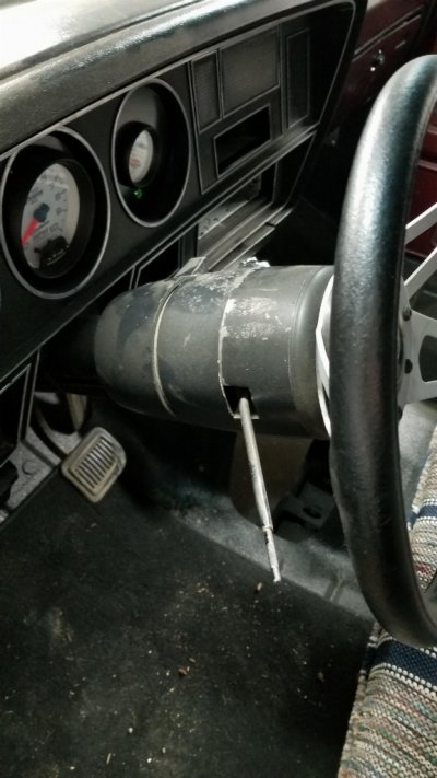

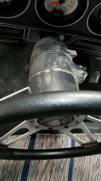

What year and make is this steering column? Cant seem to find it.

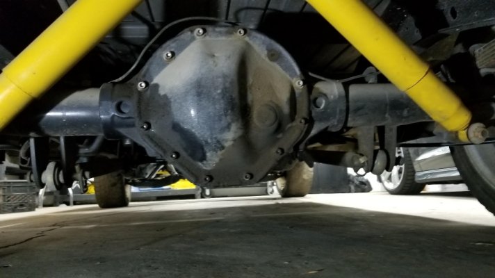

Pic of the rear thats in the truck currently

looks like it may be the factory column for the truck. i think they used that style till 87 or maybe 88. then the turn signal lever got more complicated with wipers/dimmer switch.
looks like a standard 9.25 rear axle

thanks for the reply. Im guessing the notch on the collar behind the steering wheel is for tilt? (it doesnt do anything currently)

ahhh its a collar lock!
