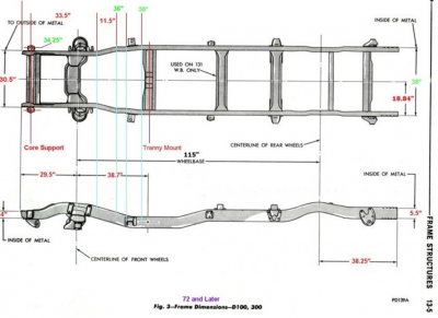

Anyone have a d150 frame dimensions sheet? I took measurements last night, but Id like to compare.

the frame was essentially the same from 1972 until the last ram d150. the shape of some of the cross members are different but dimensions are essentially identical.

Sweet, thanx for that! My measurements were pretty spot on, so thats good to know
