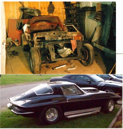

It can be done. Remember you're basically just removing the sheet metal and wrapping the '51 stuff around the existing chassis. Lots and lots of measuring, and hopefully you won't have to modify the length or width of the chassis. Spend more time taking stuff loose than trying to hurry and get it drivable, make sure you label them and take pictures, then you can figure out where you're going to put them once you start assembly. You're going to have to do some modifications for sure along the way, and you're only going to find them out when they reach up and slap you in the face.
It sounds like a great idea, and I really admire you for tackling it at 72. I'm 68 and i guess I've worn my body out doing life instead of just letting it happen. Small tasks are almost beyond me, and even things like changing an upper radiator hose on a Jeep Cherokee I6 took me 3 hours. Just keep the patience and determination and you can do it. Inspiration? $1200 Corvette that I rolled in like a wheel barrow and brought home in 2 pickups and a flat bed. Lot of work, imagination and figuring out how something works, but it was fun :) Yea, that's the same car in both pics

Buckneccid. Yes I FOUND A 1968 427 CORVETTE ABOUT 25 YEARS AGO. It didn't have but about 30k on it . & I went to another customer that built custom Rides. & So I took my customer to my other customer & no 2 owned that Corvette. & in about 3 months It was rolling again.
I couldn't wait to go see each of those guys once a week.
......... & Yes I understand how some crazy stuff happens .. When I put that 4BT into my 1972 BRONCO . It was cut patch & mold & paint it or under coat it.. But I loved coming up with some crazy way to regenerate some aspect on mating those 2 together.
& It a rather nice Unit to have on the farm.
