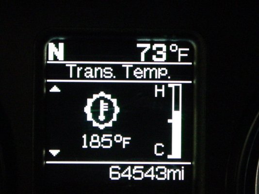

Took it out for a good run cycling all gears up down and sideways.
trans temp stayed at ~ 185 in 75-80 degree heat.
will likely recheck the level just to amuse myself and because the burns are healing nicely . Can't say I looked at it before but I'm guessing this is typical ? :favorites13:
