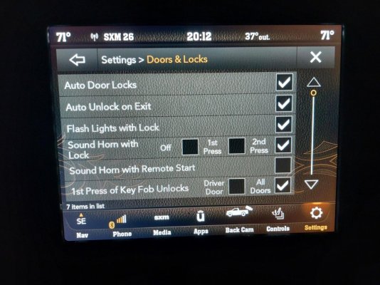

Ive went into settings to turn off the horn honking when locking the doors and it still honked when i locked them. No option to turn it off when unlocking that i see.
Am i doing it wrong?
2023 Rebel. So many options to look for...only had it a few days lol.

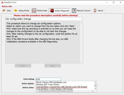

There are numerous tweaks on our trucks, making it hard to keep up.
Your truck may have different setting options than mine, but my Uconnect 8.4C has the adjustments under Settings/Door & Locks.

Or, this CSM option can be set with AlfaOBD, at least on my truck. :cool:
What is that Alpha ODB? A tuner? And yes mine looks simliar though i have the 12" screen. Put it to ff and it still honks :mad:
Also want to turn off the horn for unlock

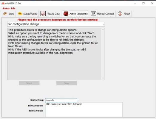

Do you have the Lock settings options in your Uconnect configured the same as I've posted above?
AlfaOBD is a software App that allows us to tweak or customize the BCM and other modules on our trucks. The URL for the AlfaOBD thread is shown in my signature line.
Buy directly from this site, not from elsewhere, unless you want to spend more $.
You will also require an OBD interface and a Security Gateway Bypass cable. And, either a Windows PC or an Android device. I use a windoze laptop and a USB interface.
This is a commonly used Bluetooth/OBD interface. On sale today for $112.
And the preferred SGW bypass cable.
I haven't tried disabling this option, but it's on my list now. :cool:

I did. It didnt beep when i locked the doors but it beeped when i shut the door lol. Im just going to have to get this alpha OBD. Eventually im going to reprogram the tire sizes to calibrate with the speedo. Been reading about it.
