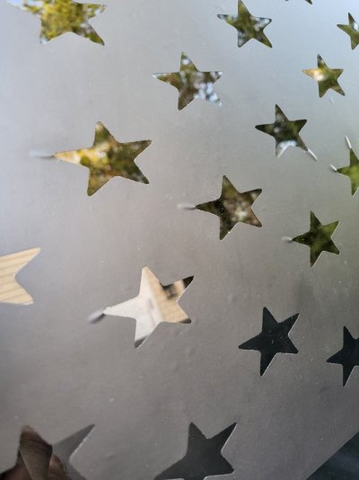

Here are the stars. This question is for the experienced vinyl guys. Should I put a slit in these to get them to lay flat? I've tried pushing them down but they won't stay.

Good point, I didn't think about them turning up. I'll try that tomorrow. Getting a little late today.

Don't put a slit, instead just puncture the center of the bubble with a needle and press out the air ...

A heat gun will work too, but most of the time those go away especially with the sun, give it a week or 2 before you start messing with them though ...
