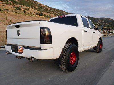

New Red Shoes: 35" Tires w/Icon Stage 2

I dig the red accent on the wheels with your white truck came out very nice.
Also nice choice in your suspension. Did you also go with the matching Icon 2.5 rear shocks ?
Thread title says stage 2, so I'm assuming he's got the 2.0s in the rear. OP can obviously confirm though.

Level pic... i kept the front coil-overs turned at whatever they were shipped at, they could be raised another inch.
There's a before pic with the stock height too.
How much rake do you have? I'm debating whether or not I'll adjust the coilovers at 1st install or leave them as is for awhile. I'd prefer around 1-1.5" rake.
The rake is about 1.5" on level ground with the coilovers set 1" below max height.
