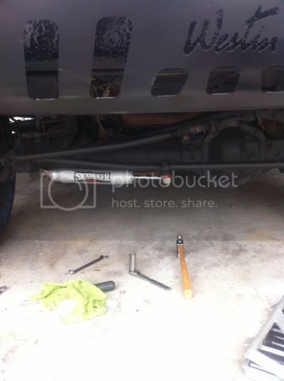

OK , on to the review and pics ..
First of all .. slick looking mono tube shock design . Rears mount like stock fronts mount cylinder up ... kinda weird but after looking around thats how most off road shocks like a fox ect mount . Kinda cool IMO .
Bushings ... they are very good polly bushings , not the normal feel to them , they feel 100x better .
Ride ... 110% better than the previous shock (duh)
Being a mono tube shock the only other mono tube shock I have used is Bilstein 5100's so I will compare the two as they are both the same design .
Price vs the Bilstein .. depending where you get them the same price .
Feel ... now I only put on 30 miles on these on smooth and bumpy roads , so far IMO they are very similar to the 5100's ... if I had to say better or worse I would say better. Basing that on the dampening and rebound characteristics of these M95's on my lifted truck they feel better than the 5100's .
Now this is just my opinion and I am a 4 time 5100 guy .. had them in 4 different trucks.
Would I recommend these ? Without a doubt .
As I put more miles on them I will update . But in all for the same price as a 5100 these hold up to and IMO exceed the 5100's
So on to the Skyjacker M95's ... nice silver tone to them , cool decal ... awesome performance on and off road for the 30 mile trip I took .
Steering Stablizer also a M95
Front
Rear , with Hellwig

Feels good !
