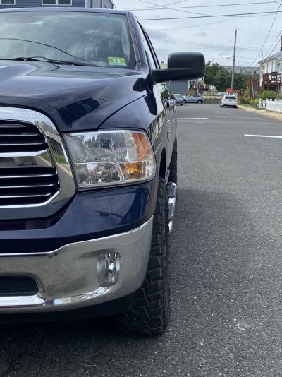

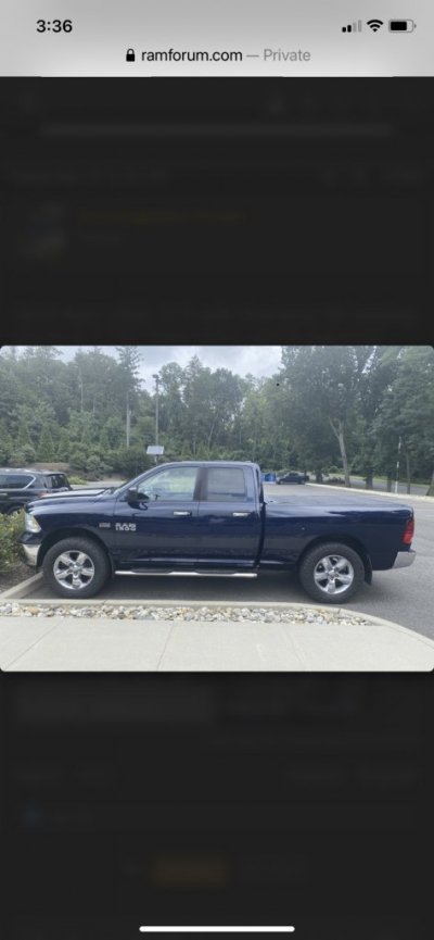

That’s the look I want. Any idea how much MPG you lost going from the stock tire to these?
My last truck a Yukon XL I would get 14-15 local and never more than 18 Hwy. My Ram I am getting 16-17 local and up to 24 hwy with usually about 21. I kind of like that especially with gas prices going up. It’s the primary reason I haven’t traded my truck in for a new 2500.

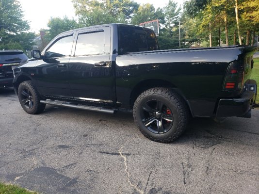

They have the Cooper AT3 XLT's now that are more aggressive. Remember that you have a pick up truck with all the weight in the front most people writing reviews dont remember that. You can up size if you are looking for a little more meat. All manufactures vary is actual dimensions so its best to find the tire first. I prefer the Toyo At3 as an all around great tire. However I have sold a lot 30+ sets of the cooper At3 XLT in 2021 so far with zero complaints and Im in your region of the world

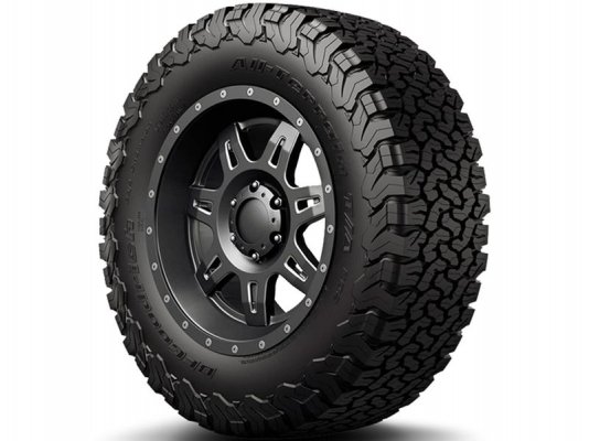

Some people have no issues, Id get some other opinions but even with 3.55 the shifting and lag is noticable to me. I should also mention I started with the stock size (275.60.20) with my first set of BFG A/Ts after the lift and noticed no MPG difference from the goodyears. I think you would be fine with 275.65.20 and it should save you some $. A half an inch wont be that noticable IMHO. Good luck, post pics for us!!

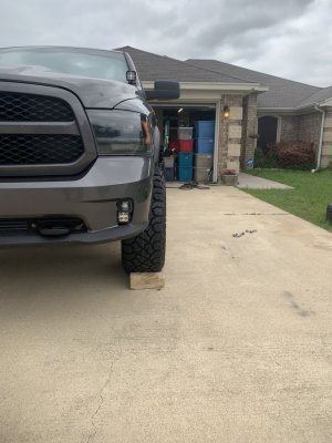

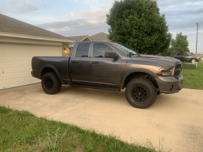

I was running 275/65/20 on my OEM rims with Zone UCAs and Bilstein 5100s (@2.8) and I got the life of them at 50k miles on the Cooper Discoverer ATP/AT3. That size looks good as such and I didn’t need to trim the fender liners or no rubbing on the suspension. They ran well all the way to the end, but did get squirrelly when I “played” in the rain.
After getting my money’s worth (after 6 years) I just replaced them a month or 2 ago with 35s and new wheels. Pro Comp 32 17x9 -6 with Kenda Klever R/T 35/12.5/17 . . . but now they look small on my truck just leveled and a (Zone 1.5”) body lift.

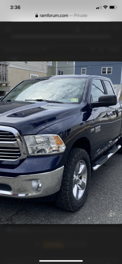

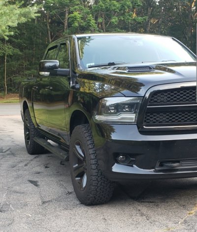

Well I got the new tires earlier this week. I ended up getting the Cooper Discoverer Rugged Treks in 275/65r20. The advertised specs are slightly bigger than most 285/65’s at 34.7/11.5. So far they are much better in turns than the AT3’s I had before and nearly as supple on the bumps. They are noticeably heavier and at least on local driving I went from 16-17 to 14-14.5. Not the end of the world.
