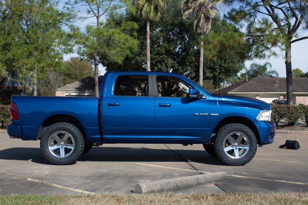

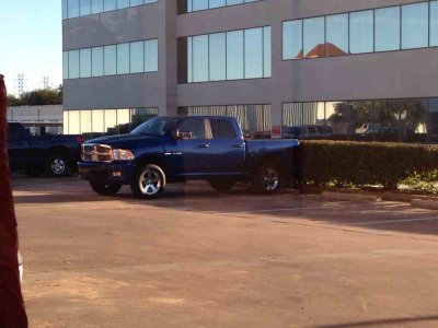

Now the wait time sets in!
Tires trail grapps 295/65r20 stock rim!
More high quality pics to come with dslr
Update new rims installed!
Wait a second... I'm posting from an iPhone?

There on and mounted! But yes they do rub at full lock on the upper control arm I'll post some pics in the morning and where they rub at.
Then found out the last place I got the tires rotated they must of lost the wheel lock key so now I have pay $48 for new ones
Specs
09 ram sport 4x4
Bilstiens 5100 @ 2.1
295/65r20 stock rim chrome clad

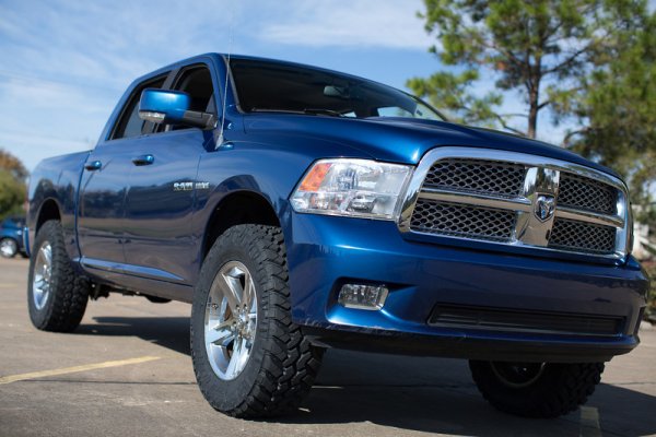

here are the Pics more to come when i have some time!
Sweeet. How does it ride? Bumpy? Noisy?
Sent from my DROID RAZR using Tapatalk
The road noise is there and present at 50mph above. I feel like the truck has an over all better ride to it than the other pos tires I had before (some brand called mastercraft) it's not bumpy at all but now I would to do a gear swap and some new shoes do that they don't rub

Yes, it rubs at full lock other than that its all good. does anyone know what the factory offset the chrome clads are and if I where to change rims what would be a good offset that sticks out the least and not rub the control arm.
Cruizer
Sep 16, 2013
6,816
2,427
Ohio
2010 Sport 4x4 QC
Believe OEM offset on are +18 or +19. I hear people talk about -12 for 12.5" wide tires. You're about 11.6", I'd think you would be cool with a 0 offset.
