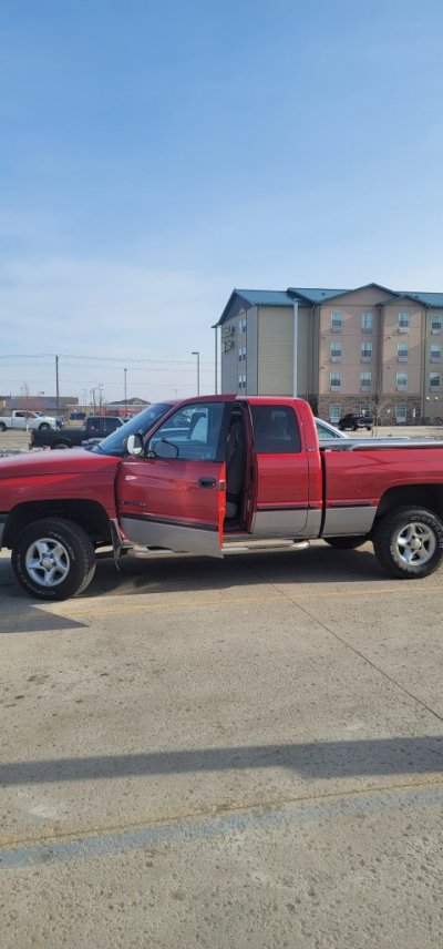

Hello all,
I just got my first dodge with a 5.9 magnum and was wondering about swapping out the 360 for something bigger that's plug n play. Do I need to change transmission? Seen something about a 408? Just looking for more snort in the low end. .any suggestions? It's a 1999 Laramie Slt.
