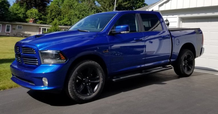

Hello Group!
New here looking for knowledge!
2015 RAM bought new off the showroom floor. They had done a ram air hood swap and Magnaflow exhaust system with some kind of chip(?) and could bury the speedo on the highway! New updates over the first couple years wiped the fun out though and now she stops at 105.
Love my truck but didn't know about engine issues all this time. Planned on this being my last vehicle and been running Royal Purple synthetic all the way and now she has 213,700 miles even on original plugs with nothing other than 3 sets of tires and a brake job a couple years ago ( Powerstop stuff).
Talked to a friend last year in Upstate NY and his RAM had exhaust manifolds changes 3 times at $1600 each time he said and I said WHY? He said "known issue". So my truck had a tiny noise when started that went away in like 10 seconds so he mentioned my gaskets were probably on the way out. Told him maybe my flow through exhaust saved me that.
This was in 2023!
Fast forward to a few weeks ago and after a typical 35 minute highway drive with no issues I walk out and start my truck and it's misfiring until I drive 500 yards to the road then pinging for a second when driving down the road. Had a random misfire code then cleared then turned into a p0303 cylinder 3 misfire. Wish I knew of issues with the engine 2 months ago so I could have scheduled a cam/lifter job! Now I need an engine!
Will post in the other areas when I search some more and let everyone know more specifics!
