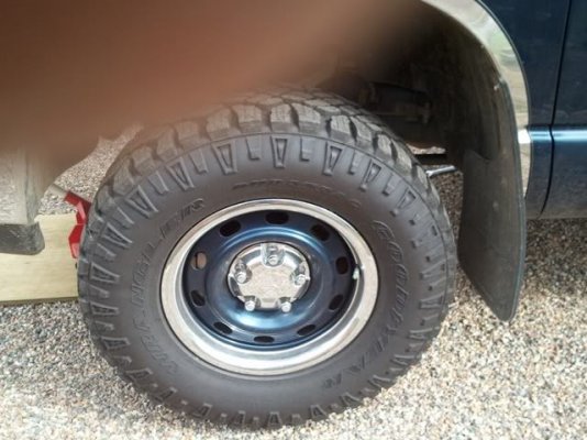

Read the reviews. These are the expensive ones and not the irregulars sold at walmart and called Wranglers. Just for info the 285/70/17 is same overall height as the 305/65/17 Pro-comps just not as wide.
This is when I had em on these rims with white lettering in.
Edit: Sorry misread your Text, if your going 6 inch lift definately go with the Tire size recommended by Assassin.

Rides like a Caddy and very Quiet even at 80 MPH. Mileage rating? I beleive they do not yet have a mileage rating cause they are relatively new but scored 9 out of 10 from customer reviews.
Also they have impressive speed rating (see pasted info):
The Wrangler DuraTrac is Goodyear's On-/Off-Road Commercial Traction light truck tire .... Speed Rating “Q” = 99mph (160kph) 115/112Q.
