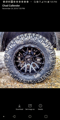

After not being able to find a 18" wheel that I liked, that was also light, I ended up going with another set of 20" wheels. I've narrowed my choices of tires down to the Michelin Defender LTX M/S and the Mickey Thompson Deegan 38 all-terrains. 95% of my driving is on asphalt, but I do still need the ability to drive on dirt, grass, etc and have traction.
Does anyone have any thoughts on how well the Michelins do when they are not on asphalt?
And does anyone have any experience with the Deegan 38's, in regards to their longevity, and rolling resistance?
I've ruled out the Nitto Terra Grapplers because of reviews that don't speak well to their longevity, and balancing issues. I had Firestone Destination A/Ts on my old truck, but they've changed the make up of the tire since I had them, and I didnt get full mileage out of the old set, so now that the tread depth is less then before, I don't trust them.89e3698fb8e425732c26fc82d33fc320.jpg
