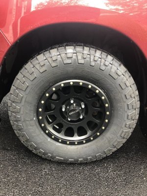

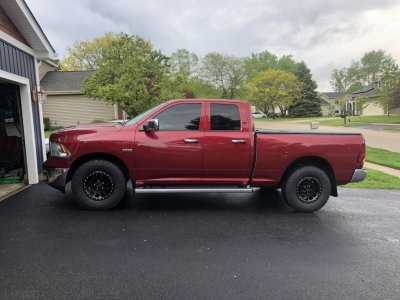

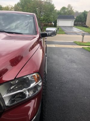

Hey guys. Figured I'd post this up to help out other looking for wheel/tire options on stock suspension, and to show off how much I like them. Truck is a 2013 Bighorn Hemi. Went with the Method Racing 17" NVs with a 0mm offset and 285/75/17 Cooper AT3 XLTs. They are a 33.8"x11.6" tire and don't rub or anything without a lift or level. I think the profile is just right without messing with flares, lifts, etc.
I'll say the tires look and drive great. Every bit as quiet as the factory SRA's and look like they have plenty of bite for the light deer season offroading I'll do. So far (a week) I've somehow picked up about .5mpg too, but we will see if that continues. Thanks for taking a look.

Those tires look great. I am looking at my next pair of shoes for the truck and this helps a ton - thanks for the pics!
