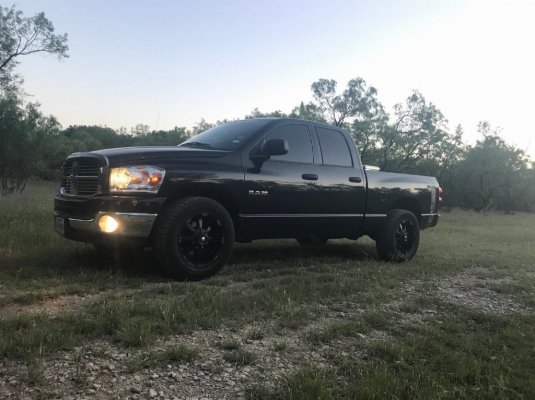

It was a good price but unfortunately came in and didn’t fit. They were a “scratch and dent” item but had no damage on them, but they listed the wrong bolt pattern so had to return them. Ended up with Ballistic Morax 20x9 0 offset instead so I didn’t have to level. I haul a lot of stuff in the bed and didn’t want the squatted look when hauling stuff. Here’s a pic. 9e1cf23139e627e321fb903900890efd.jpg

I like the wheels!

how long have you had them on, and any issues with the wheels cracking at the bolt holes?
