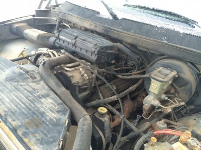

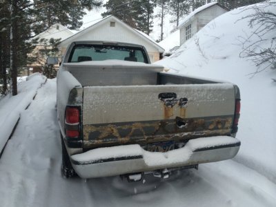

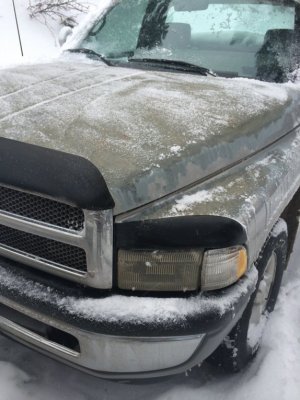

thanks for the input guys, here's some pics as requested, and a little follow-up... I changed the oil, windshield wipers, and checked the plugs, cap and rotor the day after I got it... and the brake pads/ rotors turned this weekend... the shoes looked good, maybe i'm just particular like that... but that's the mechanic coming out, I'd rather it start/go/stop before I worry about the rest...Now if it would ever quit snowing I'll tackle the rest

Bumper looks good, and that surprises me. Wheel arch doesn't look too bad, I've seen much worse on that year truck but holy hell! That tailgate! Is that a rust hole I see on the right side?! :eek:
Oh, yeah, and in the case of your driver's side headlamp housing, the housing itself is leaking. No way to fix it besides full replacement.

Unfortunately that is a ton of rust on the Tailgate, all the way through,(that one spot on the bed above the arch is the only spot on the body) but the Local JY's have them for around $80-$125 ... and if i'm going to re-coat it I don't have to worry about the color, same with the passenger door... another $100 I've been looking at lights and they look like around $75, they're both in the same shape, I love the idea of adding more lights as well, I haven't really thought of that, My Powerstroke puts out more than enough with the clear lenses and i was hoping the dodge would too, but a decent set of fog lights look like a good option, there's too many critters out at 5:30 am when I'm leaving the house... he's some more pics as well...

Door and tailgate definitely. lol Engine bay looks good, minus dirt. Nothing looks hacked up that I can see, belt looks fairly new unless you've replaced it.
Headlight housings are anywhere from $50-100 per side, so not cheap, but they're necessary. I say start out with housings, bulbs and a relay kit and go from there in that regard. i put more lights on my rig because I have the habit of driving at high speeds late at night. :angels25::evillol:
