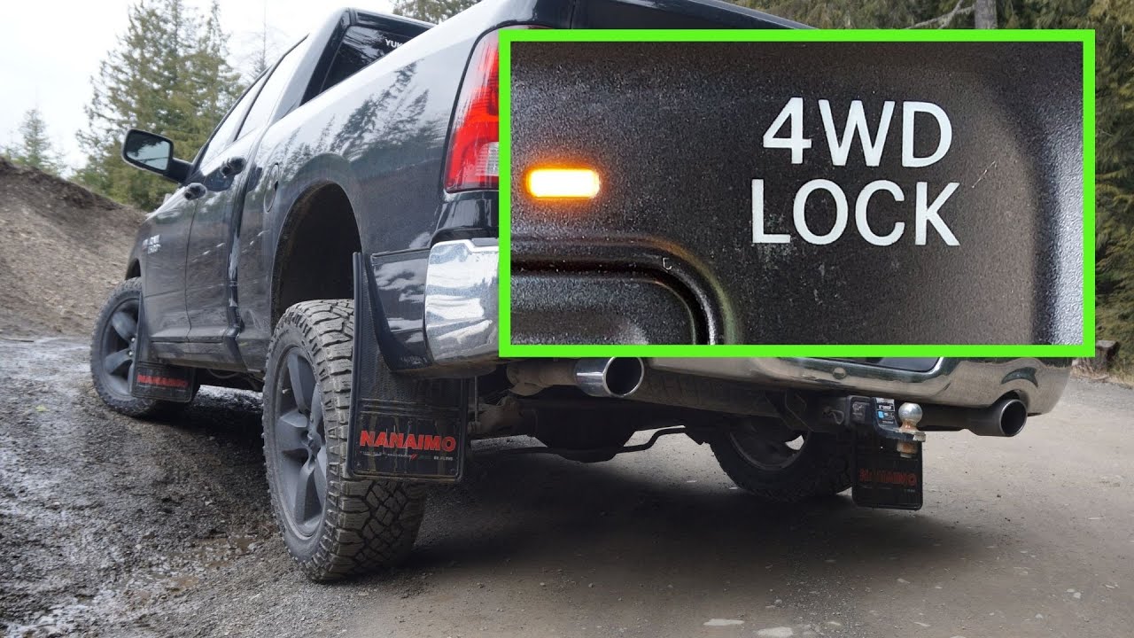

I think some people are confusing the locking of the hubs with the locking of the differential. The Rebel is still an open front diff, you aren't locking the front wheels together (nor were you with the old manual hubs if you didn't have a locking diff). Power is not always evenly split between the front wheels and they can turn at different rates. Get stuck and watch.
Shows it at the very beginning. 1500, but same thing.
What's "locked" is one wheel on the front and one wheel on the rear, whichever has the least traction. On a turn, the front is tracking the outside of the circle while the rear is tracking a curve much closer to the inside of the circle, so they are covering different distances but forced to turn at the same rpm.
