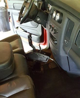

The company sells a relay kit which includes a small electronic device that taps into the warning light of the gauge, which you preset thru the annunciator, that triggers a relay (or a solenoid in my case)Max, looking great.. well done. I'll have to look at my Aeroforce gauge. I can set a alert on most any input, but I don't think I can do any external triggering.
So, for example, i set the warning light to come on when the gauge reads coolant temps above 186 degrees which at the same time triggers your relay
