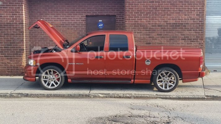

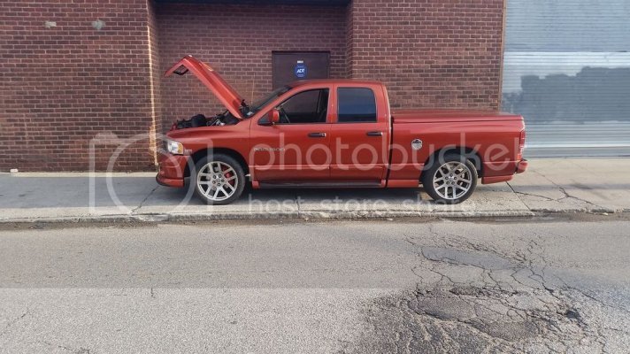

Yeah dude, i saw your pics! Your setup is awesome, very unique! Hoping that everything goes well for you! Good luck with the rest of the build
Looks great.. Hooebyou don't have to change spark plugs anytime soon lol

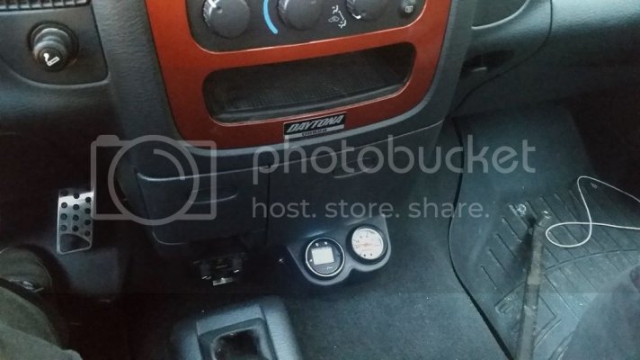

I like the gauge placement. I tapped my dome light wire behind the A-pillar for my gauge power on my '07. I never could get the dimmer line to ever work except to just activate the night mode but I eventually cut those wires because it would cut out the dimmer function every so often.

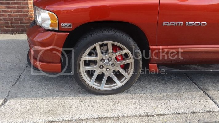

I have another question, is there a company that sells 3/16 or maybe 1/4" hubcentric wheel spacer for these trucks? Thanks
