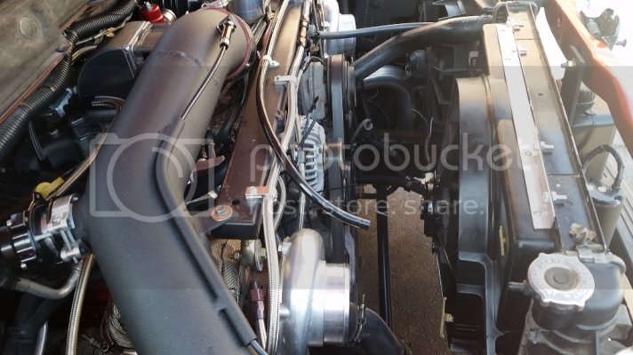

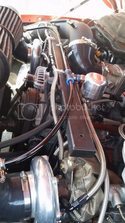

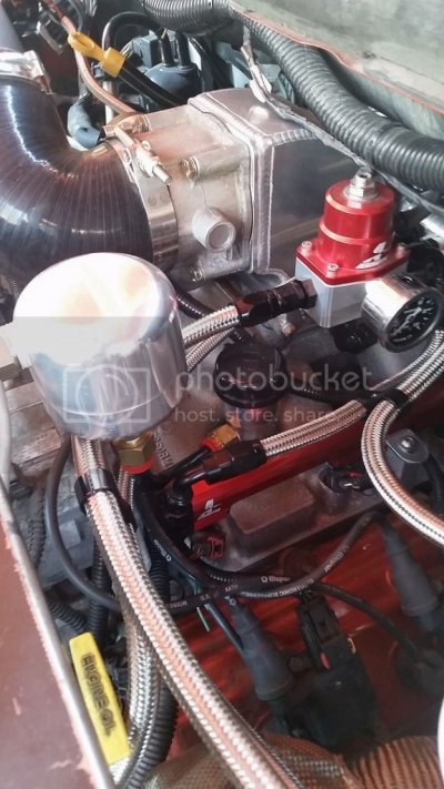

Hello everyone!. I had not updated in a while as i was waiting for the truck to be tuned before posting anything else. Well, it is not going to happen as planned. I was supposed to meet with my tuner this Friday, but he has something going on and we wont be able to do it this week. I am a little disappointed but whatever, we are working on rescheduling maybe for next week.
I can say though that i finished the pcv system. One part works just like stock (under vacuum ) except for having the catch can and a check valve. The other half for which I added a couple of pictures, would work under boost and it consists of a line coming from the oil filler neck to a small oil separator then going to the turbos.

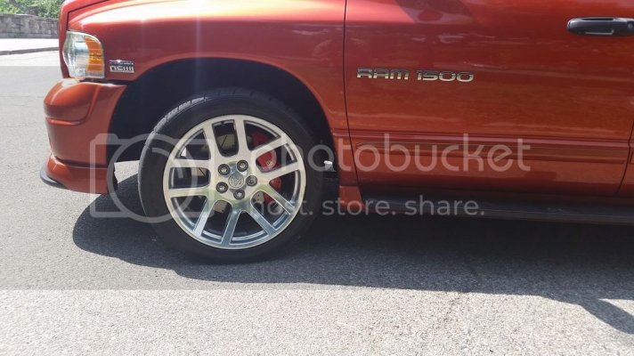

I am also looking for suggestions. This is not performance oriented, but i will ask anyways, i want to paint the calipets, but i am not sure what color to go with. What color do you think would look good? I have thought of dark grey or same color as the body (go mango) or maybe black? Any suggestions? Anyways here are the pcv lines to the turbos

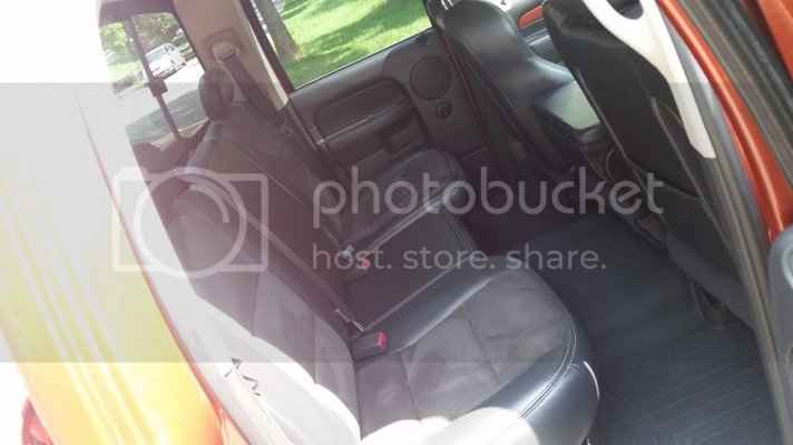

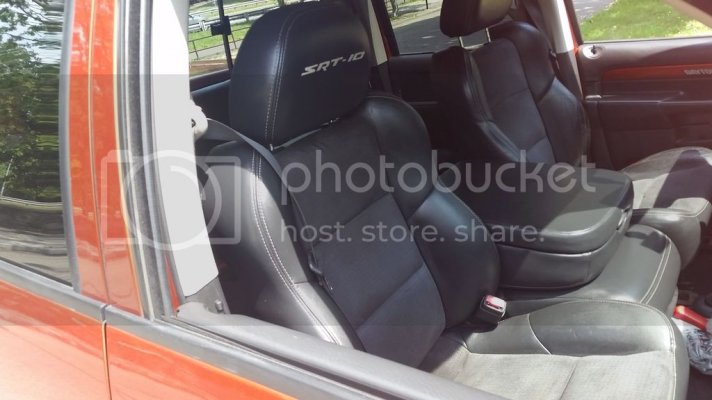

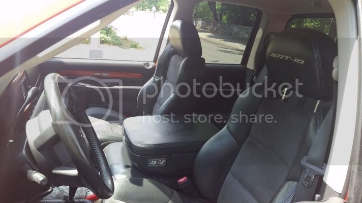

The SRT10 seats went in and it made a huge difference in the looks and feel department! I will get in touch with a guy on Tuesday to see if he can redo the head rest and replace the SRT10 logo with the Daytona logo. I am thinking spelling the "Daytona" logo with 2 "t" (twin turbo). I will see what i can come up with.
I also took the opportunity and cleaned the truck, this thing had not seen a vacuum or soap and water since i started the build! LOL
As for tuning, i am in communication with AJ and we are trying to arrange something for this coming Thursday (fingers crossed) anyways here are a few pics

I love it, wish I could do SRT10 seats in mine, I need the better bolsters for cornering.

Yes, it was a good find (i had been looking for almost a year!) Though i had to drive 200 miles to get them

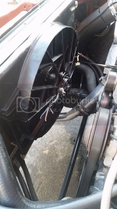

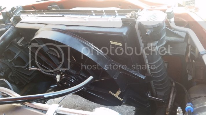

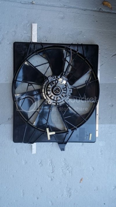

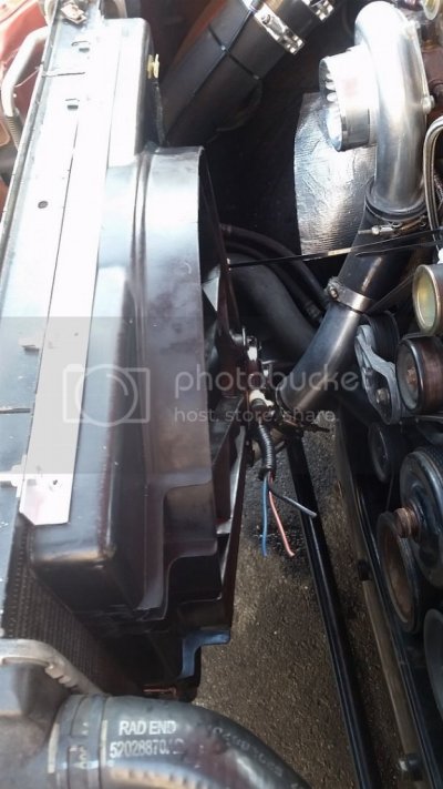

I am in the process of installing an electric fan. I bought a junkyard Lincoln mark viii cooling fan, an 85amp solenoid (this fans draw a lot of amp upon start up) and will have the Aeroforce gauge control the fan. I made good progress today making moumting brackets for the fan. It is very simple, just an angle bracket on top riveted to the fan and bolted thru existing holes in the radiator. On the sides, 1 "L" bracket on each side of the fan so that it can rest on the same mounting ears just like stock.
I finished most of the wiring just need to hook up the posivite and ground wire going to the fan and that would complete the project. Hopefully i get to that tomorrow, although they are calling for rain all day :\
Some pics
Will post some more tomorrow if i get to finish it

Max, looking great.. well done. I'll have to look at my Aeroforce gauge. I can set a alert on most any input, but I don't think I can do any external triggering.
